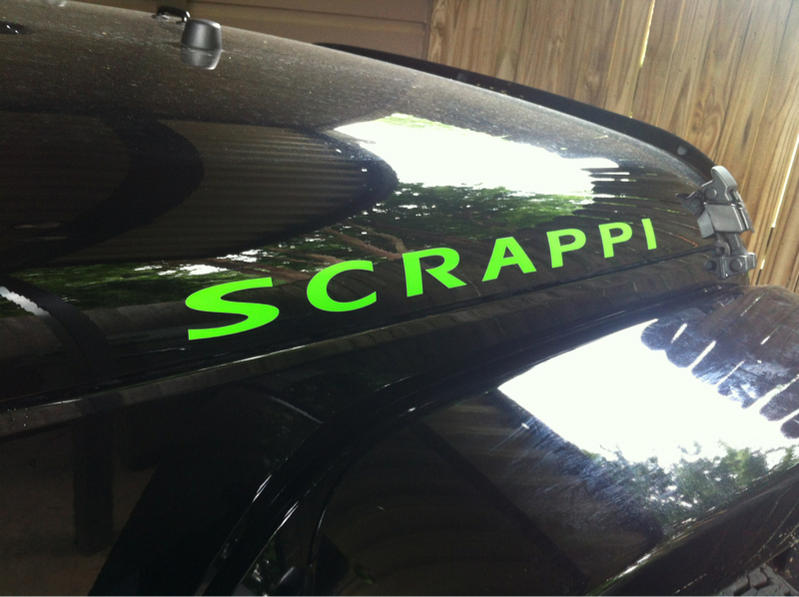

I cleaned surface and sprayed soap n water on hood and was easily able to move the decal around to desired area.
I also sprayed the decal with backing still on with water to help it peel off paper better.

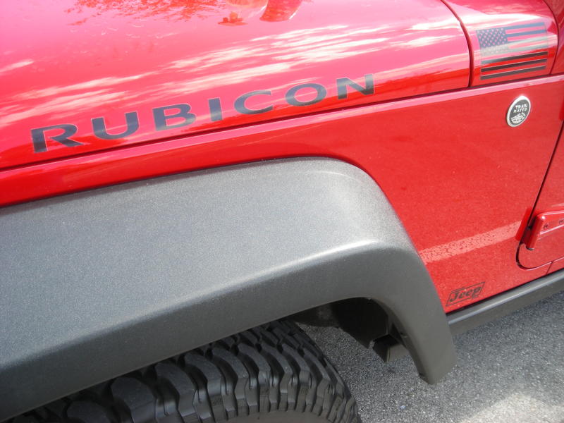

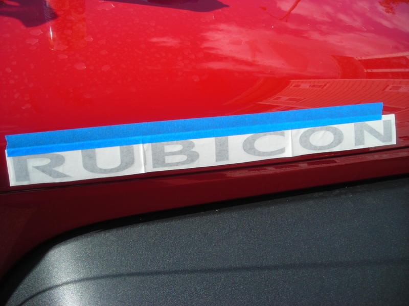

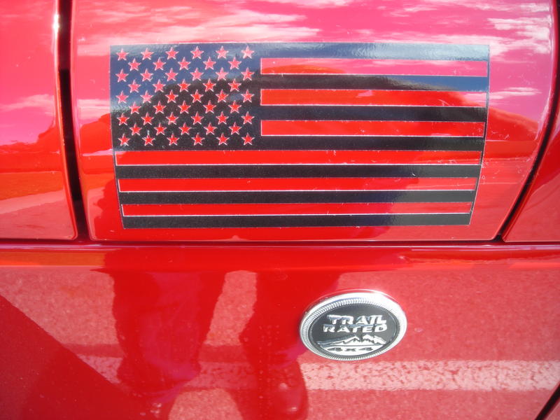

Use tape to make a hinge, flip up, remove backing, spray with soapy water, flip down and squeegee out the bubbles

I like your hinge idea. I eyeballed mine and they came out straight but it was stressful. I love this forum!!

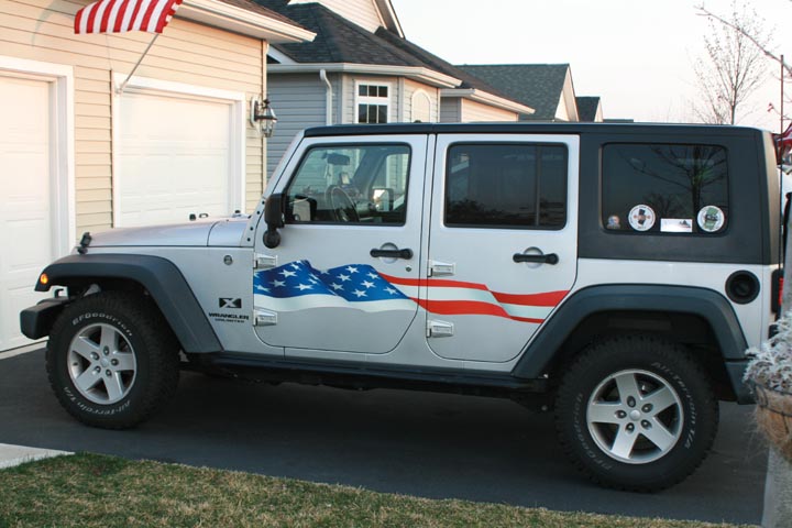

Have a professional do it.....

bah! take ownership, and have the confidence to do it yourself! it's not that hard, with these forums and the knowledge base at hand makes most jobs peeps spends $100's on simple and stress free.

I had mine designed, cut and installed by a graphics place. I couldn't find anything stock that was near what I wanted. This place took a picture of the side of my Jeep, I told him basically what I wanted, (waving flag design, had to fit between the hinges) and he emailed me a couple of proofs. Tweaked it until we agreed on the design. Next day it was printed, and it took about 45 minutes to install.
No way could I find that design or similiar as a stock item.
