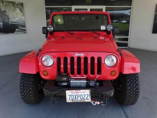

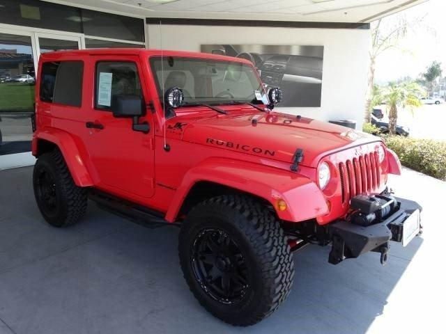

Hello gang,
So there is a really sweet looking 2013 JKR with AT at a local dealer for sale and I'm very interested in buying it. It has 9,400 miles on the clock and it seems very clean. The previous owner is also a JK Forum member. I went by and inspected the JK. The previous owner installed some Rancho skid plates on the differentials. I noticed there was oil around the diff and on the actual skid plate. I'm worried this JK ran with low oil to no oil in the diffs. How can I make sure no damage was done to the diffs? My guess is the skid plates were not installed properly, causing the oil to leak. What can I do to ensure I won't be buying a lemon?

Did you end up buying the jeep? Looks pretty nice. Would have the dealer fix the leaks also before taking delivery if you do.
