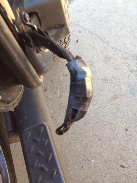

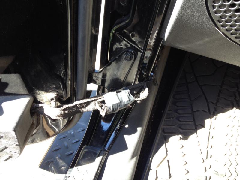

If your like me & never want to plug them back in just wrap them with some electrical tape
ID:	555442   Click image for larger version
