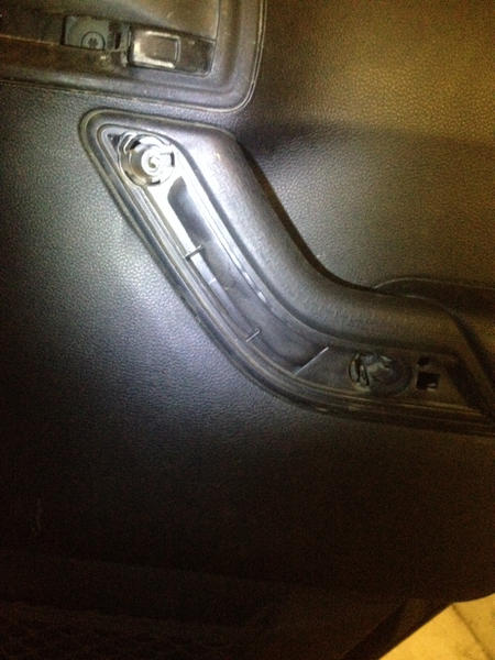

I took care of this today, didn't take long, even with forgetting to put the grommet back in place before reassembling the door panel. I actually did this before but had no luck in getting the sticky part moving again. The first time I did it, I forgot to put the grommet back as well. Awesome. Anyway here's a quick break down with some pics. Click image for larger version

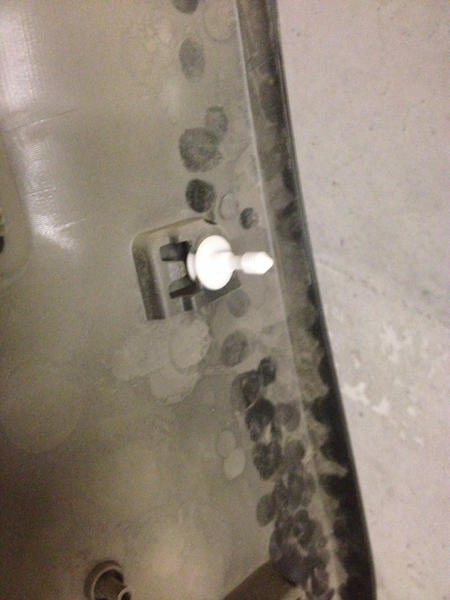

ID:	547403 Use a 5/16 Allen to remove this. There are two screws under here that need to be removed with a Phillips screwdriver. Click image for larger version

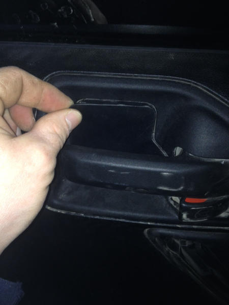

ID:	547405 Than pop this off with a flat screw driver or something similar. Click image for larger version

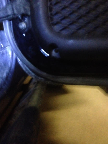

ID:	547407 Under that is a T25 screw that needs to come out. After that remove these two screws, also with a T25. Click image for larger version

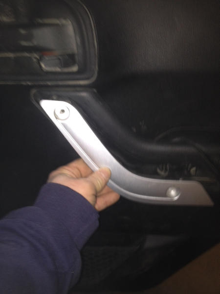

ID:	547408 Click image for larger version

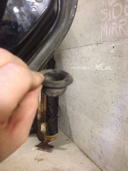

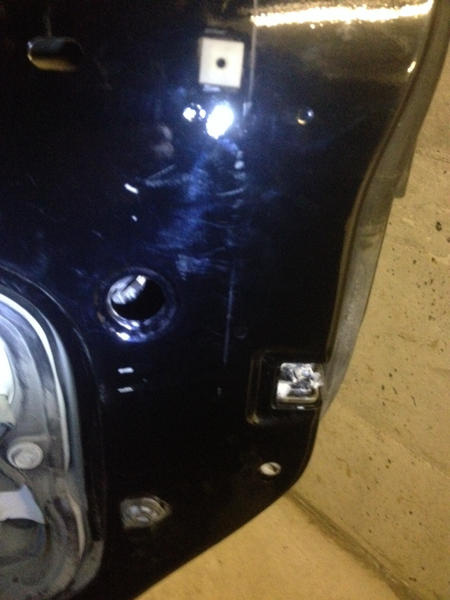

It will take a bit of maneuvering to get the panel off the top and around the door handle, but it's not to bad. Once it's off remove the rubber grommet opposite the door handle. Here you can see the hole from the grommet and the latch mechanism at the outer edge if the door.

Use a flash light to peer into the hole and locate the mechanisms that need to be lubed. Spray some lube in as best you can. I used WD40 and lithium grease on the outer latch. Work the the button a few timed until everything is loosened up. Now reverse the steps and reassemble everthing, but don't forget to put the grommet back in.
