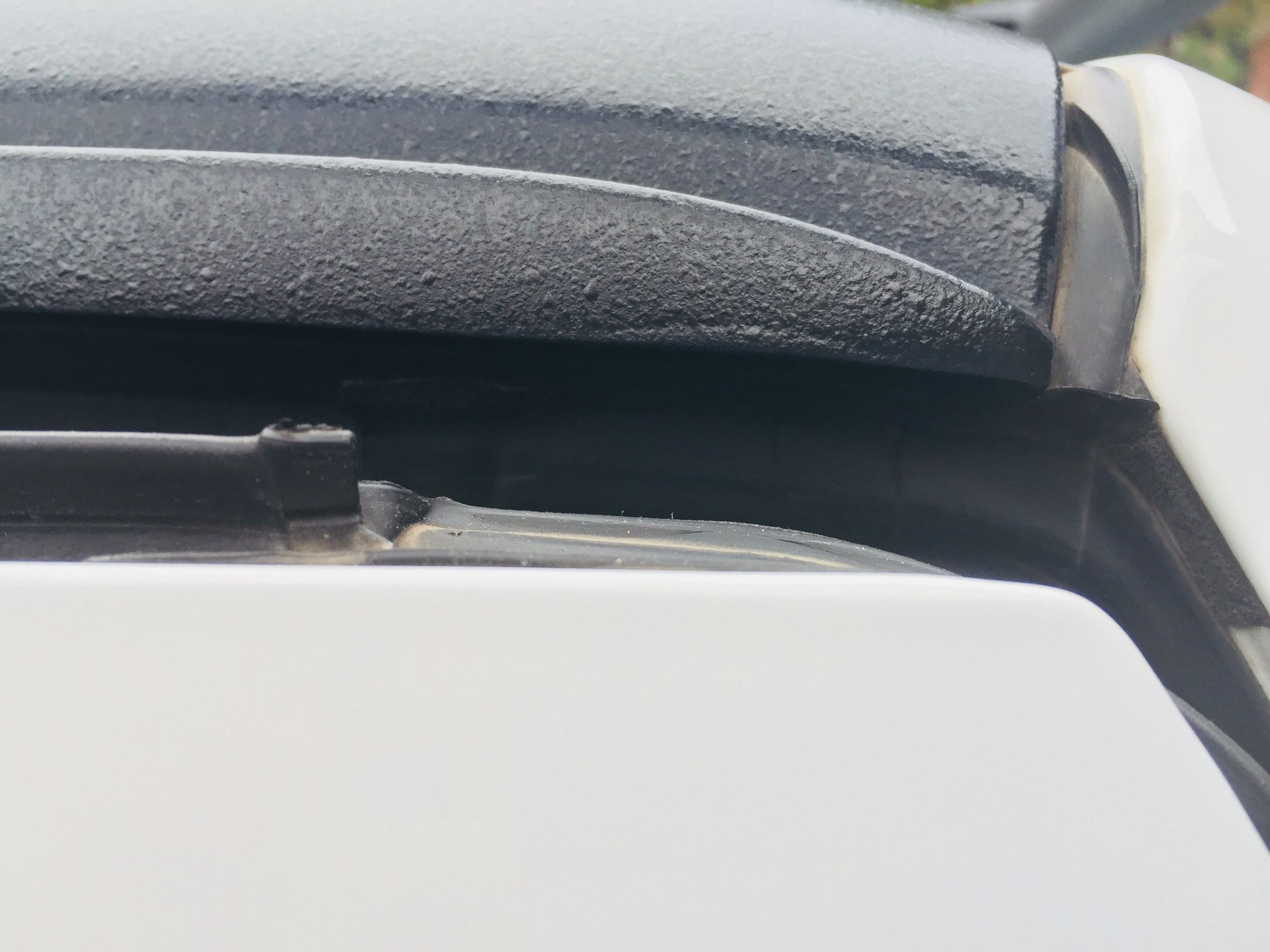

Our 2014 hardtop JK leaks around the molding at the top and most forward point of the driver's door. The molding looks exactly the same on both sides, but only the driver's side leaks. [original molding] If the wind is blowing the water comes right in.
The curious thing is that it looks like the molding has been trimmed.

Sounds like your leak is center-line from the removable panels, while mine is from the forward end of the driver door. The area of the molding that looks like it has been trimmed, but has not. See picture.
