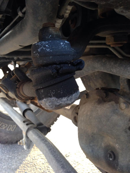

A few days ago I started hearing a noise when I turn sharply to the right. I inspected the front end of the Jeep and saw that the bushing on the drivers side of the drag link was squashed pretty good and broken with grease around it. I don't have a lot of slop in the front tires except for when I hit a good bump or am on a rough road. Can I just replace the drivers side end of the drag link? I'll try to snap a picture after work.
Edit: Here's a pic

You definitely can. Drag link comes in 3 part numbers if memory serves right. The two parts of the shaft and the turn buckle. The driver side being the cheaper one as it is quite a bit shorter.

I'd put the $70 towards a Synergy DL. The joints on the stock DL are junk.

Yep, 3 parts
Driver long, the sleeve and the joint which you can get at any auto store.
You might be able to pic up a Crown/Moog unit local.
I have a stocker, you can have it if shipping doesn't suck.

I'll probably go down and get a Moog since it's available here.
