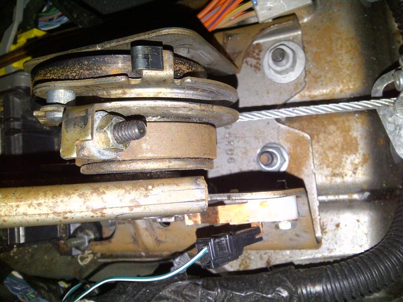

This is my first post so I hope it's helpful. I have been through 2 parking brakes, and finally tried fix of my own. The same spring breaks on the handle, at the same location yours broke. The clutch spring is supposed to pick up any slack in the cables, but does not appear to do its job very well.
I took pictures after the repair, so can't provide exact measurements on metal length.
Not sure how long your parking brake lasted, mine was around 8 months each.

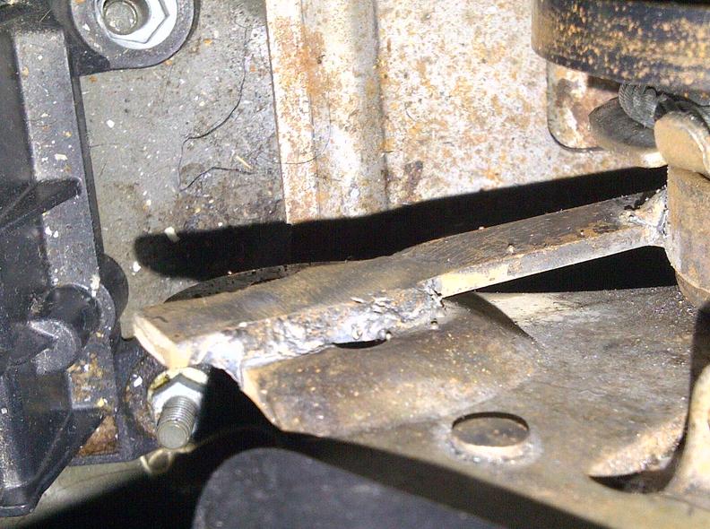

What i did was remove the broken clutch spring, and replaced it using 1/2" steel wrapped around the drum.
Welded an arm to the handle, and used an allen head bolt to clamp it tight on the drum. It cannot be welded to the drum, because that's pretty much the only adjustment available for the handle.
The pin was a problem, and needed to be welded back to the handle on drivers side, not planning to fix it again so I'm not worried. It can be popped out using a hammer and punch.
The slot on the passenger side of the pin pinches the tension spring for the cables, needs to be opened up to help release the spring. Doesn't do much after all the welding, realized it after final assembly.
steel was 1/2" x 1/8" thick, bends easy, little bit of heat helps. I wrapped it around a bar and bent up tabs to secure using the bolt. The bar was around the same size of the drum, just need something to round out the clamp.
Installed this way for 3 months, no problems.
