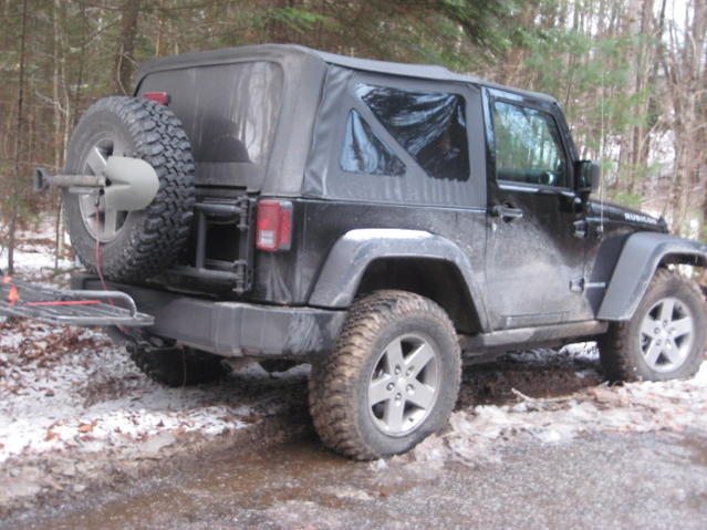

Old Dec 25, 2013 | 08:56 AM
  #30
jeepmojo's Avatar
Posts: 2,318
Likes: 12
From: New Hampshire
Default oh thats what that handle is suposed to do?
i thought it was a oh shit handle for driver when all else fails ! i feel like it will snap if i try to make it work from day one on my 12 it will hold on last click but i wouldnt put my life on this faulty and in my eyes recall rip off from chrysler on new jeep
