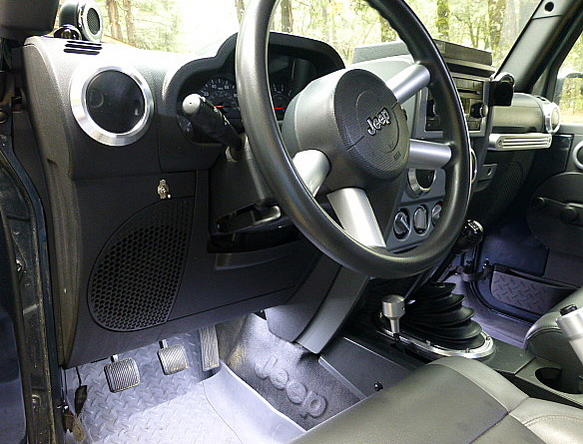

I own an 07 too. Most effective way to disable your ESP is with a kill switch. Very easy, takes 30 min. I put my switch above the driver side dash speaker. Here's the directions https://www.jk-forum.com/forums/jk-w...riteup-260247/
Old Feb 15, 2013 | 02:21 PM
k0260's Avatar
Posts: 5,234
From: Nevada City California
The kill switch works perfect, allowing you to tuen your ESP off when ever, with the ability to leave it on too.
