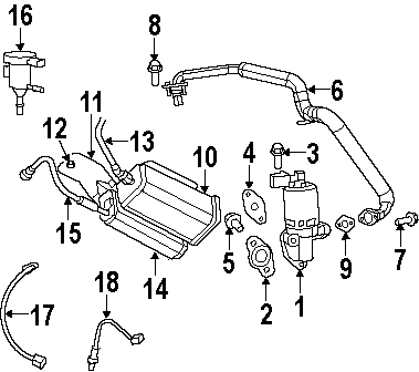

Maybe this will help?
ht tp://www.makeitjeepparts.com (OEM parts)
Old Apr 1, 2012 | 10:50 AM
holmes4x4's Avatar
Posts: 667
From: WA
Yeah I was looking at that diagram but the part I need where 15 connects, The white part, unless it is 14 and I read it wrong but 14 is all the way on the back side of the canister by the diagram, thats why i was unsure of the part
