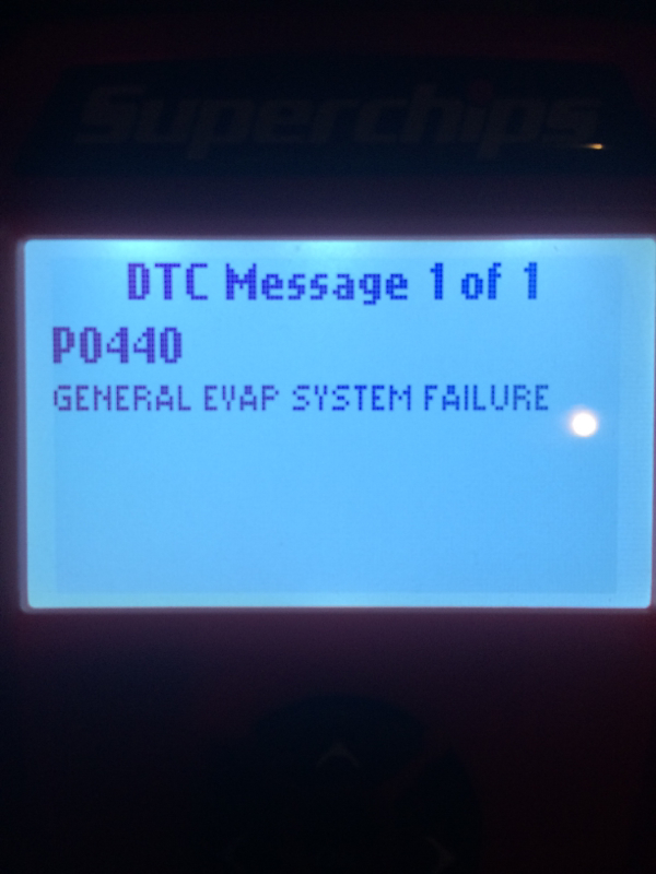

So I was getting this code.
Yes I tightened the gas cap three clicks. . I would use my superchips flashpaq to clear the code then it would come back. So I put a new gas cap on, two days later instead of a code it just said gas cap. So I tried tightening it again and it did nothing. I'm returning the gas cap tomorrow for a new one. But I was wondering if anybody else ran into this??

Check your connections on the evap itself. Have you hit it on a rock, maybe?

Before I bought a new gas cap I checked that everything seemed tight. I haven't been wheelin in months due to grenading the front end trying to pull out a juniper bush stump.
