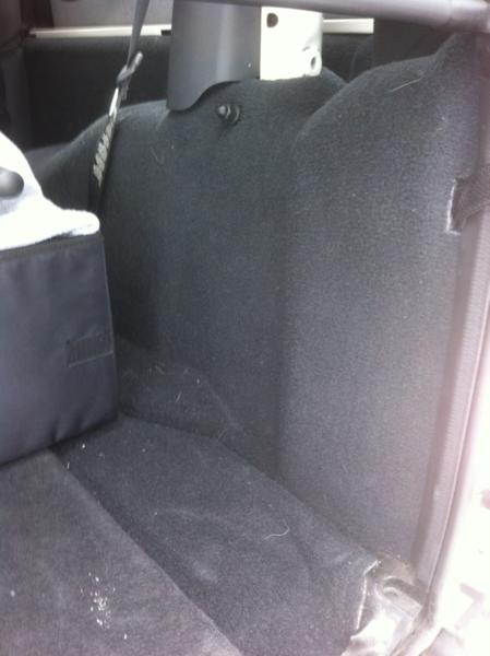

Old Jan 13, 2012 | 06:28 AM
ChaseZ's Avatar
Posts: 32
From: Saint Louis
So I just bought a factory subwoofer online. Could someone describe where the plug wire would be? Would it be under the bottom carpet or up towards the roll bar?
Here is what the area looks like now. Crappy phone pic

Old Jan 13, 2012 | 06:32 AM
Trickedjk's Avatar
Posts: 236
From: Atlanta, Georgia
Probably ran it under the carpet. Did it come with an amp or not?
