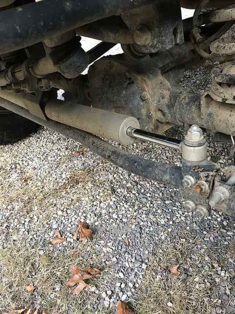

In the picture, is the trackbar the bottom black bar and is it supposed to have that bend? This connects to the pitman arm on passenger side.

Here’s another picture. The bottom bar appears to be bent up slightly, is this the trackbar? It connects to the pitman arm on the drivers side not passenger. This bar hangs lower than anything else and I did hit it on big rocks a couple times.

Thats the tie rod. Whether or not it's bent a little there won't cause the behavior you describe.
You should see this thread to get educated about the components of the front suspension and what they do.
https://www.jk-forum.com/forums/jk-w...obbles-260145/
Inspect the track bar and make sure it's attached at both ends.

It does look like your tie rod is bent and it would explain the wondering issue. Now that it is bent it just acts like a spring. You could try taking of your steering stabilizer if you want to see if there are any unwanted vibrations. The dual setup you have will hide a lot of major issues.

No way. It's certainly rigid enough to position the wheels when turning. If it was repeatedly flexing enough to oscillate like this then it would fatigue in just a few seconds and break entirely.
I agree that part needs to be replaced, but there's no way it is the sole cause of a condition where a gross steering correction is required and the vehicle lacks lateral stability. Lateral positioning of the axle relative to the frame is the entire job of the track bar.
