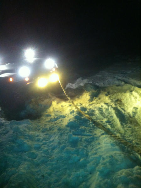

The putco h16 is a direct replacement for the 2011-13 fog light bulbs. The prs24w is from gm, the h16 replaces the gm prs24w. Currently running them in yellow on my 2012.
