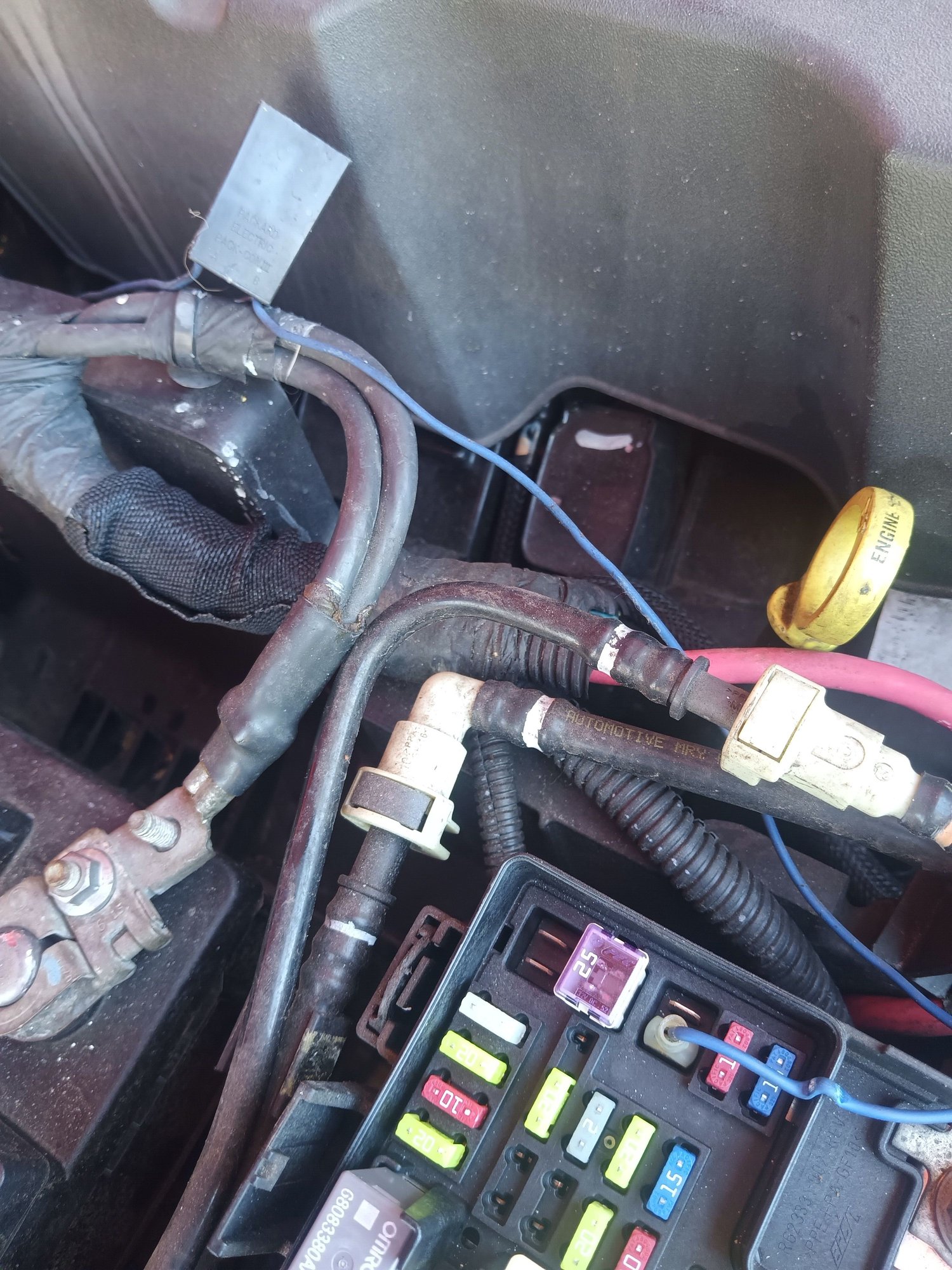

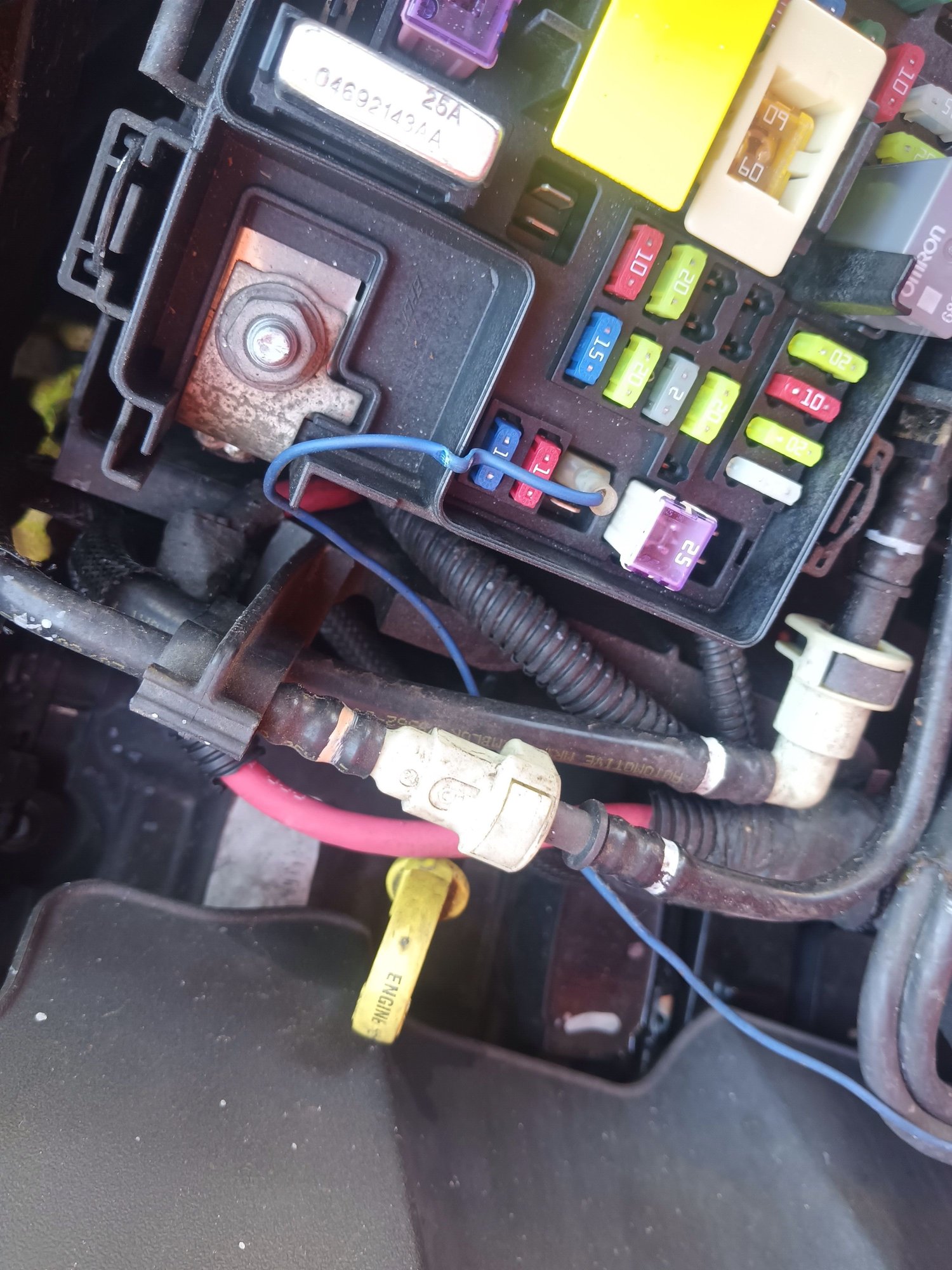

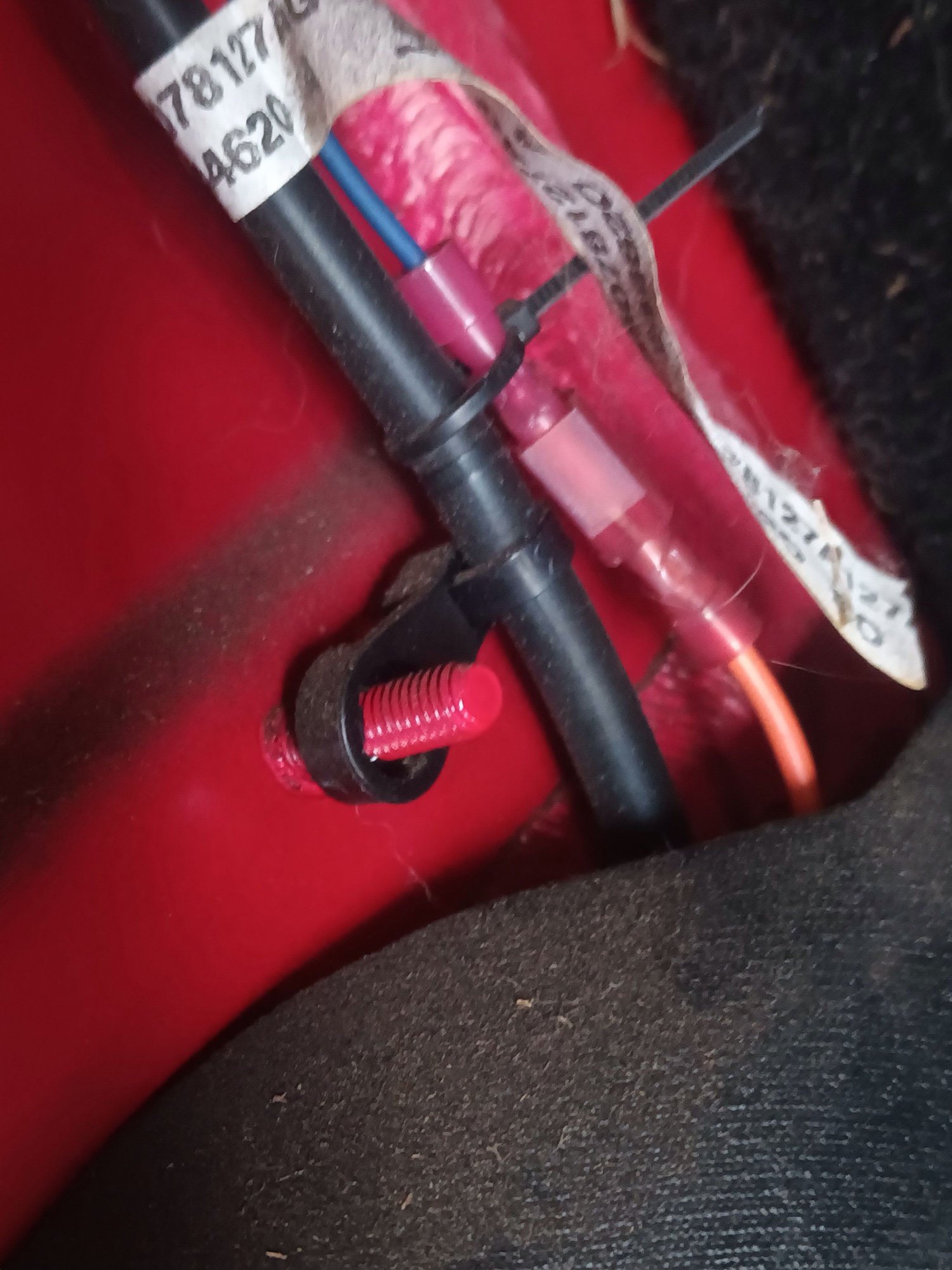

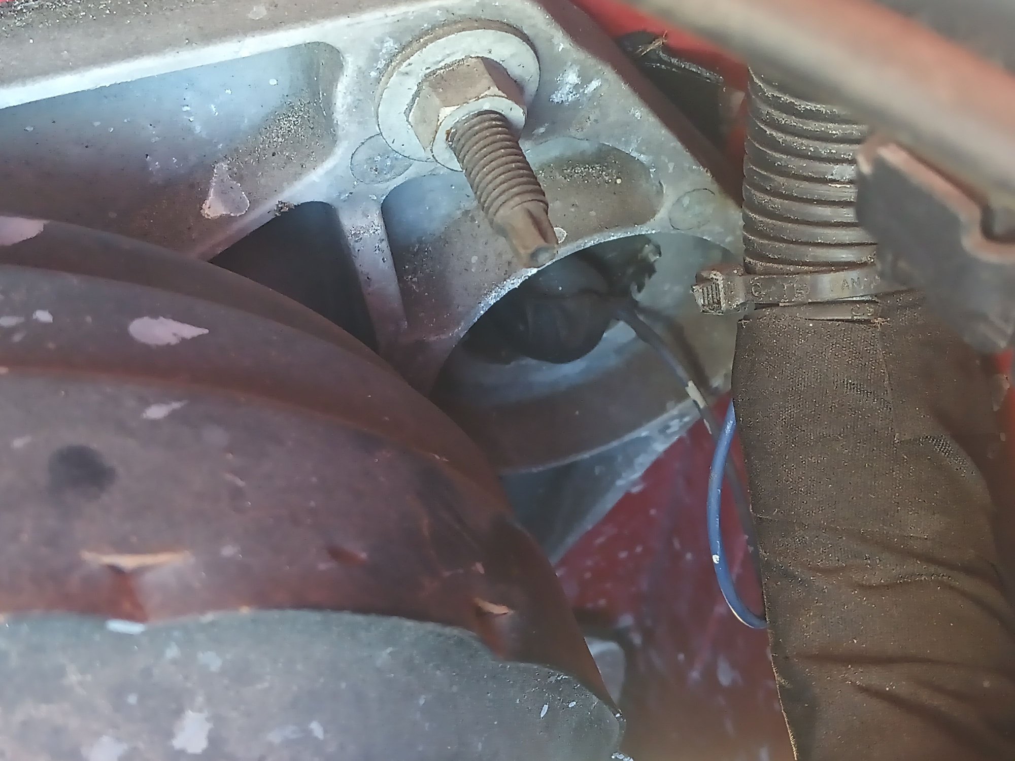

Had this 2015 wrangler Willy’s for 5 years. Recently started having ABS issues. Now Speedo not working and won’t leave first gear. Has code that comes up immediately when reset. U0121. Google suggested starting with check fuses and found this jumper in fuse block in what it says is the abs pump/esb spot. Followed it around and it goes across the fire wall and then through the firewall near the booster and and the goes under drivers side floor mat area.

That's J8 - unused in the 2015 Wrangler since it didn't come with power seats. I take it you are not the original owner? That's tapped into the unused (and unfused?) feed for whatever purpose is at the end of that blue wire. Find the end of the wire to see what it is doing.
But that's not related to the ABS issues you are having.
