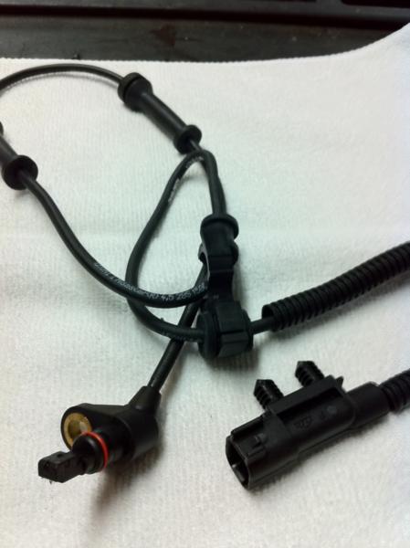

I installed the new ABS wheel speed sensor then I did the key trick and came up with no codes but a series of dashes.
I then plugged in my superchips and drew the code ( I forgot ) which stated "wheel sensor" then I cleared them and now it's all good.
The pics below are the broken speed sensor and the new one!
