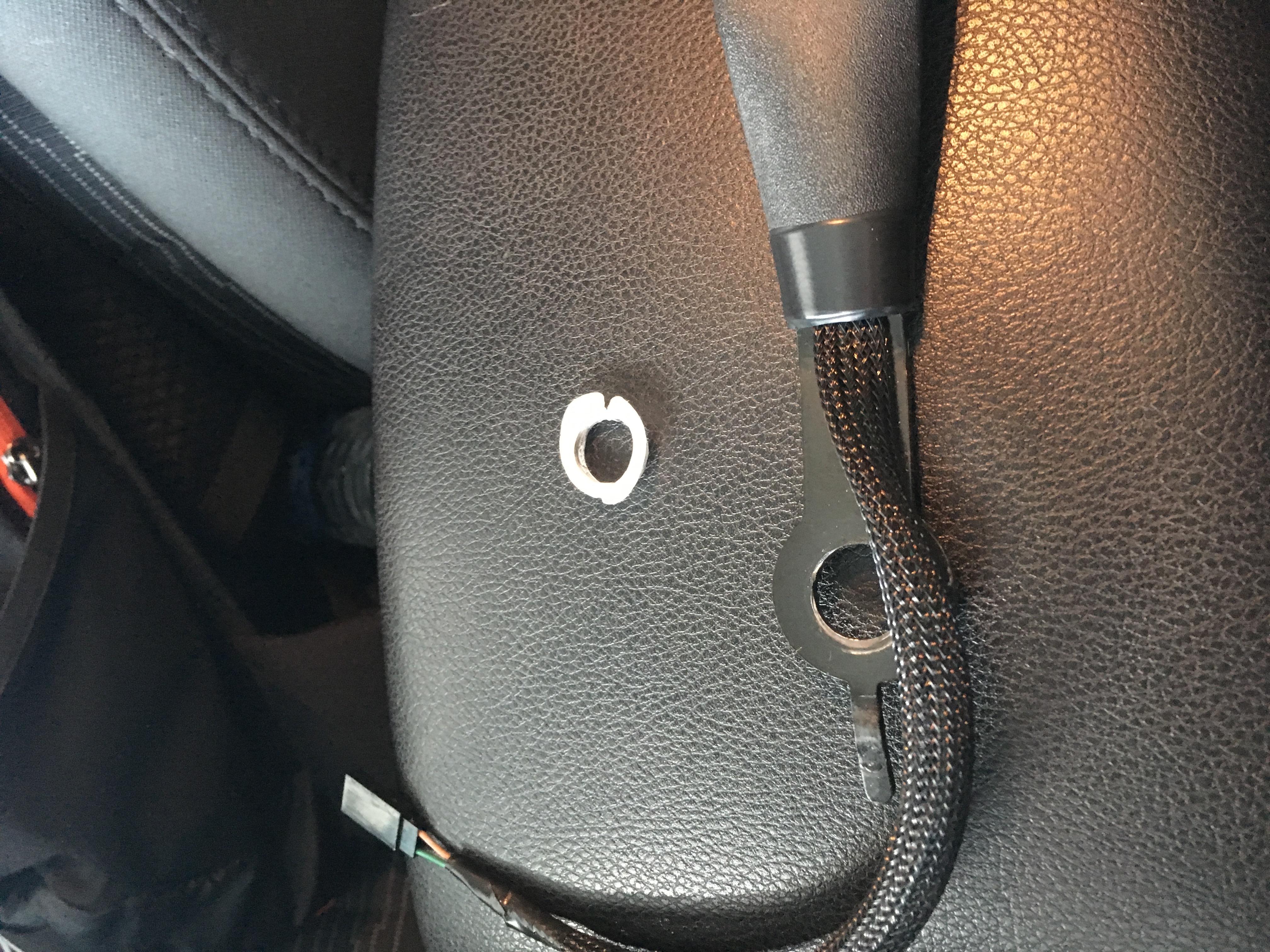

Old Mar 4, 2017 | 01:19 AM
jburtonpdx's Avatar
Joined: Nov 2016
Posts: 1
From: pataskala, OH
Default hoping to revive thread also
Drivers side belt buckle worked loose and came off.... Found the bolt and everything. I'm going to try to put it all back together today. Wondering if there are any gotchas I need to be aware of?
ID:	667646Click image for larger version
