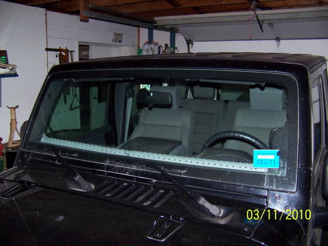

I have noted from the first wintry icy day that my JK had problems keeping the windshield clear on the sides.
The center clears very quickly, but on each side, there is a nice wedge that has problems, and in some instances, no matter how high you have the defroster cranked up, it just will not keep the corners cleared off.
The problem is not a problem of enough air flow to the windshield, as I have zero problems with the center staying clear even at a 1 setting for blower. It is the directional flow of the vents for the defroster, and the lack of the opening going much farther over to the corners of the windshield. You can crank up the blower as much as you want, but if the airflow is not being directed to the two lower corners, it isn't going to matter much.
It is certainly one of those things I would change in design in a heartbeat, and if someone could come up with some relatively inexpensive device that could attach into the whole vent channel, and add some additional venting to the sides (and not look like something Dr. Frankenstein would have designed), I would be all over it.
That said, I have gotten somewhat used to needing to pull over every 5-10 miles in some weather, pop out with the scraper, and clean up the windshield again due to the lack of the defroster being able to do its job...just have gotten used to it being one of those Jeep things I will have to put up with if I want to drive it in that weather.

I see your point...It might be very easy to devise some kind of "clip on" deflector that would channel some of the air to both sides...I could think of many ways just off the top of my head with simple materials...
I have not experienced any long term icy, blizzard conditions in my Jeep yet as we have had a very mild winter here in Southern New Hampshire....but I could see the problem in those conditions being present.
I would think an industrious person would come up with a deflector to channel air flow to the sides for the worst conditions then simply remove it for normal conditions...I would if I had this problem...
As far as the engineers that designed the defroster register being inept..I would have to agree to some degree, and it could have been a simple change to the design in the testing stages to add some deflectors into it...and solve the problem...
