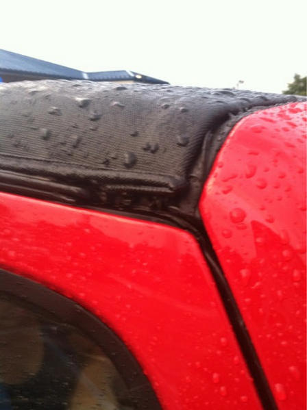

I have a 2012 soft top and it leaks bad on passenger side here is a pic on we're I think it's coming from. I need to take it to dealer.
