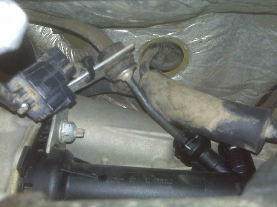

About 2 weeks ago I had to replace my clutch slave cylinder. Since than I now hear my engine when it starts up, from inside the Jeep! I look underneath the Jeep and found this:

I'm assuiming I need to cover that hole again with the rubber stopper.

In this Pic, this hole (where the point of the red pen is) is to the left of the above pic. Is that suppose be like that?

I'm going to try repluging the hole in the 1st pic today.

It looks like the plug the hose goes through the floor in just needs to be pushed back into it's hole. The other thing (you pointed at with the pen) appears to be water drain for the air conditioner, and it is supposed to be like that. That's where the water you see drip from under the Jeep comes from while the A/C is on.
