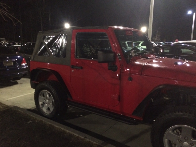

Old Mar 15, 2016 | 09:38 AM
Thadv95's Avatar
Joined: Nov 2015
Posts: 145
From: North Carolina
Just an update since a lot of people wonder about fitment. This is a factory 09 soft top with 09 door surrounds on my 2012. Everything fits great and for $40 doesn't look too bad at all. Really enjoying the weather we're getting without the hassle of pulling the hardtop off all the time. Absolutely love it
