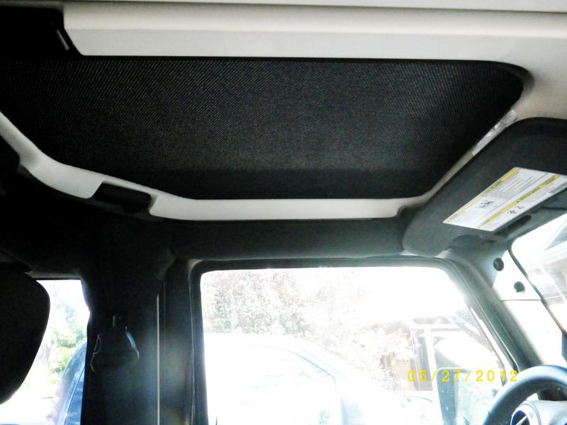

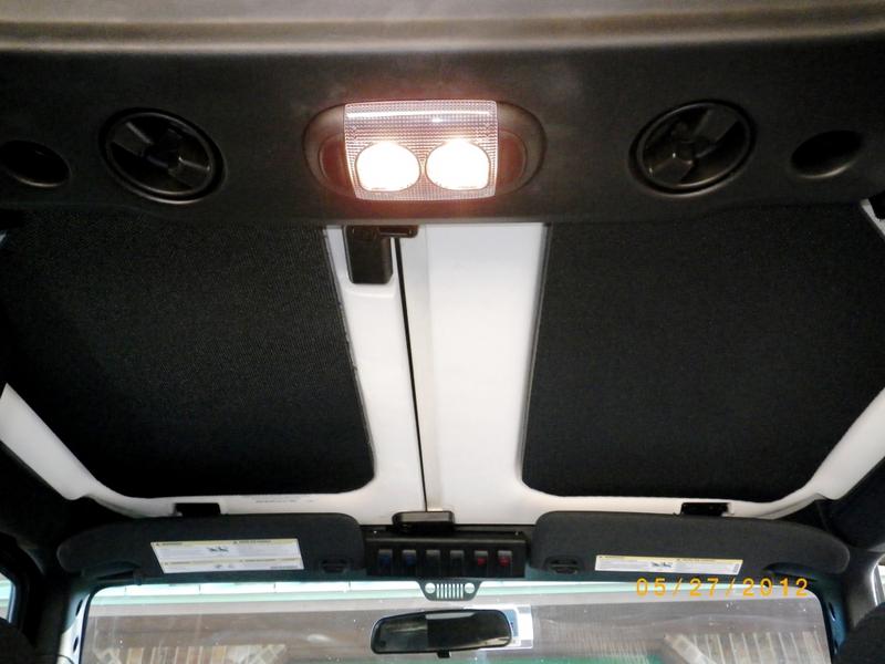

Not sure what the glue is on the boom mats but when they are stuck they are stuck. Put them on early last year and they made it through 120 days of over 100 degree temperatures here in Texas. The temperature in the jeep had to be alot more. The mats are still stuck securely to the top. Make sure and clean the surfaces well with alcohol before applying.

I can not imagine that tbhe glue on the boom mats will fail any time soon. They went through one of the hottest years on record last year and they still are holding on tight. When the back of the mats barely comes in contact with the roof it was stuck and could not be repositioned. So when installing them make sure you have the right where you want them because you can not pull them back off.
