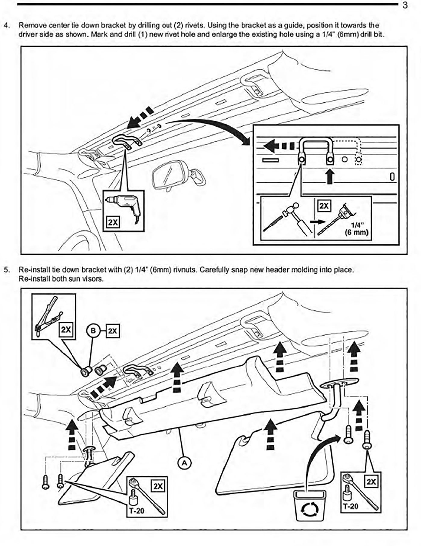

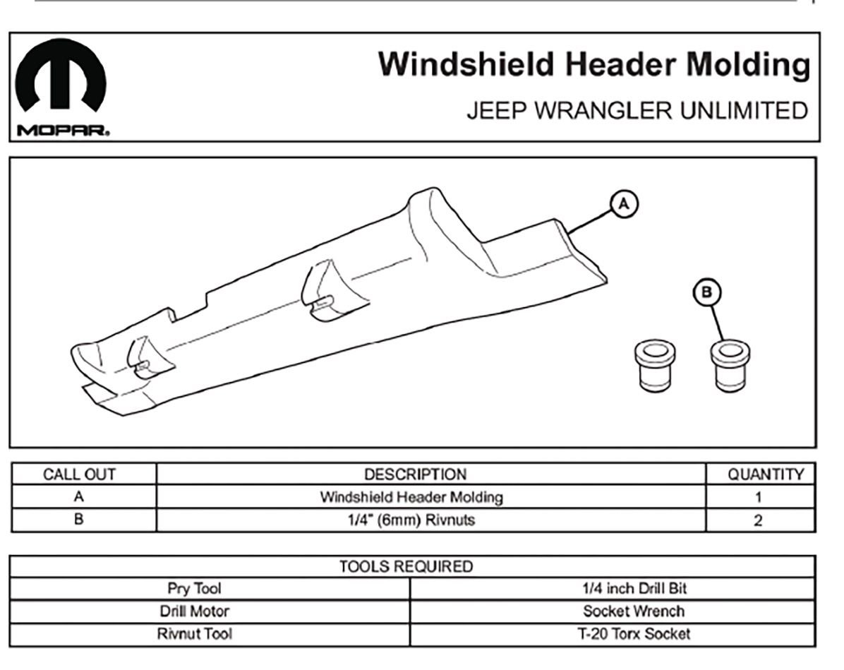

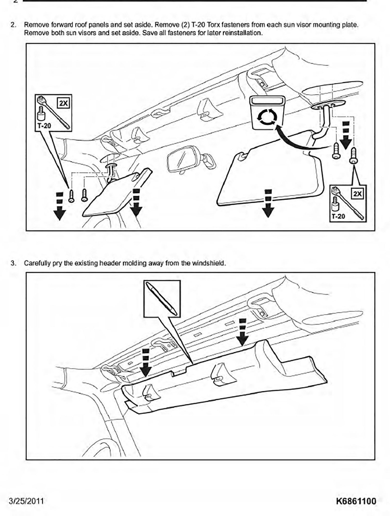

The 2dr and 4dr freedom panels are the same.
Get the later model panels if you can, they have the added front hold down.
You will have to move the center footman loop over to the left to utilize the clamp, but the panels will seal better.
You can do it yourself and cut the original trim panel, or you can get the Mopar 82212462 retrofit kit to relocate this footman loop to the left, making it compatible with the later style freedom panels.
I'll post the instructions so you see what needs to be done.
