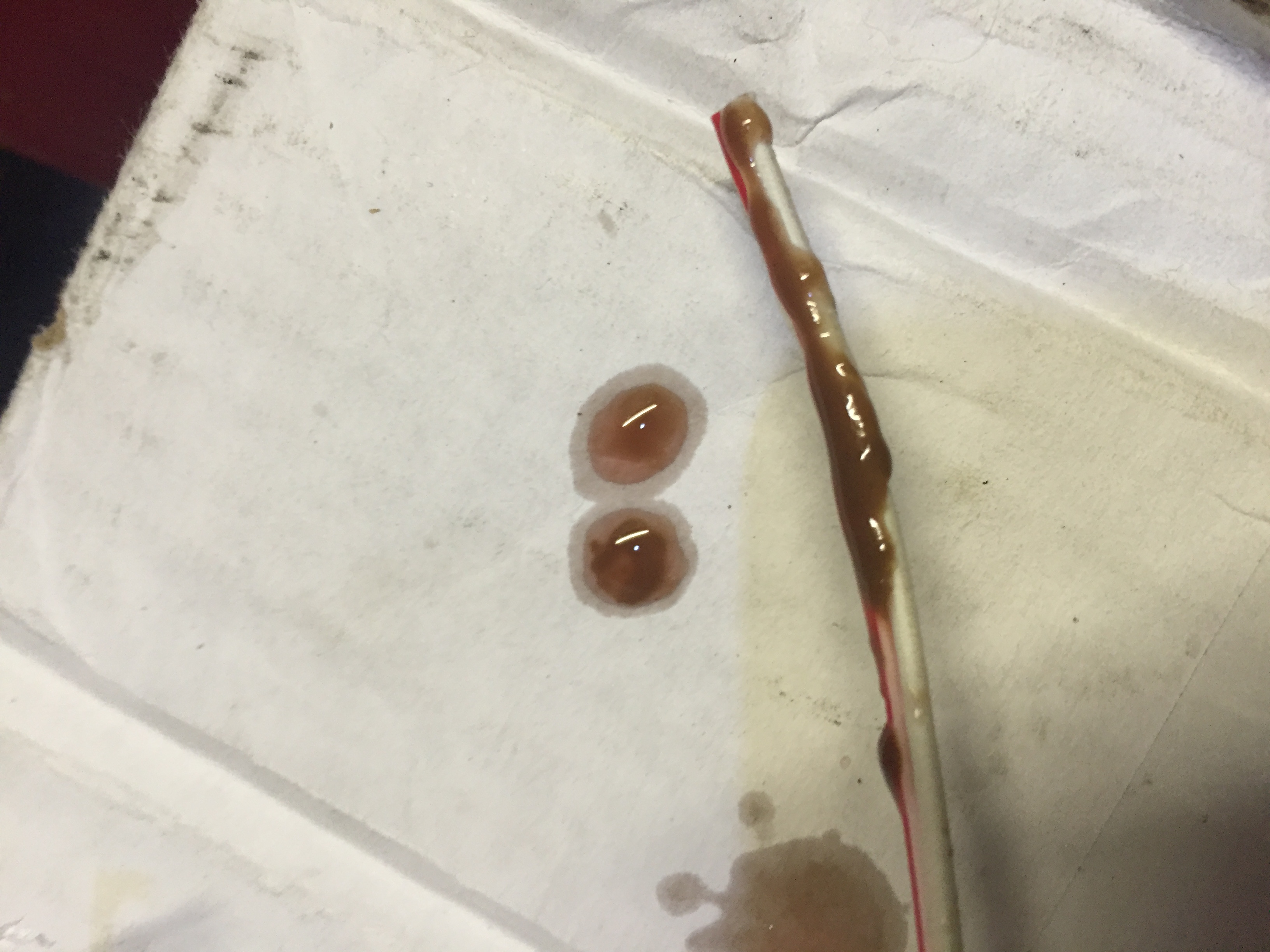

From: Blue Bell, PA
After further exploration on my daughters sure enough the sludge is there see pic. This is truly dissappointing that this issue is up to the owner to fix and not FCA when it is directly due to there processes and/or materials used. Being this isn't an inexpensive fix in the long run I am very surprised and class action hasn't been filed yet.

The 3.6L block is die cast, no sand involved. How would sand be getting in there?
Has anyone had the sludge analyzed to verify what it is?
