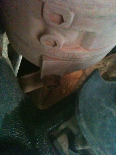

that? towards the bottom there seems to be something missing?

Old Oct 12, 2011 | 04:08 PM
ZMagic97's Avatar
Posts: 1,567
From: Goodyear, Arizona
Bingo! That's it! That's your air conditioning compressor. What seems to be missing? Hard to see it in good detail on my phone. I'm sure what's missing is your issue.

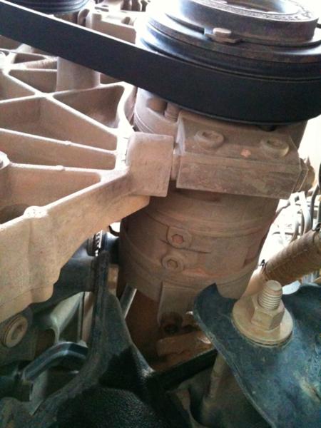

I'm not sure but looks like a tube could connect here?

Old Oct 12, 2011 | 04:47 PM
ZMagic97's Avatar
Posts: 1,567
Looks like your problem....if I'm correct that bracket is all wet or oily, correct?

No tube going to that unless I have a problem too. Just took a peak under the old girl and mine looks the same. Guessing it's something else.
