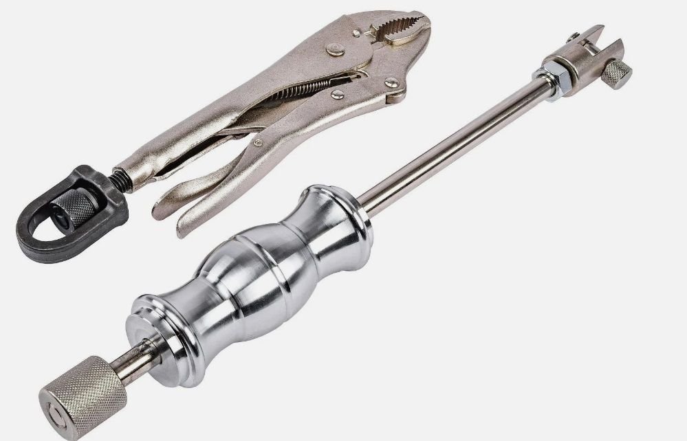

In 20-20 hindsight, the other tool that might have worked is a vice grip slap hammer. Very good for hammering force in-line, rather than perpendicularly
