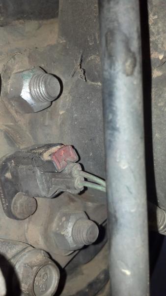

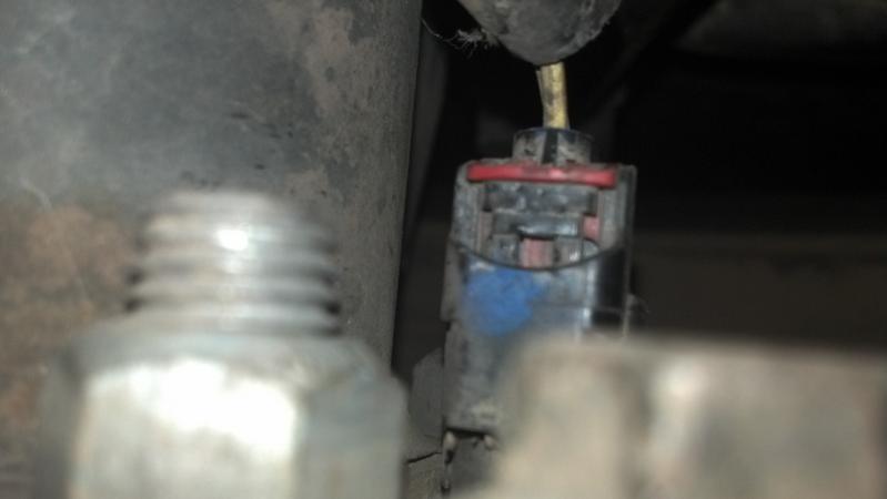

So this wheel sensor wont come out

I cant take this dam thing out!!

Old Oct 14, 2012 | 10:48 AM
rinkishJK's Avatar
Joined: Jul 2009
Posts: 4,038
From: NORTH JERSEY
The red tab is a lock tab. Pull it out till it clicks, then u can push the black tab in the center to release the plug. Then remove the bolt and pull it out.

Fuxk i just broke it!

The red tab? I was gonna say be gentle..

That's just a lock tab.. The black part keeps the plug on.. If u broke the flat part of the red tab off u might need to get the two red pieces out of the plug before the button will release it from the sensor.

Yeah it was the tab i pulled out the other side but cant take out the plug

I should work just like the ones on your doors when you unplug them.
