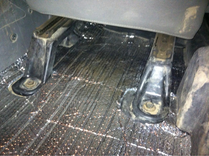

Used "Astrofoil" installed under carpet, gotta say it made it a lot quieter for sure. Did front and back, then installed carpets. Next step is to do the ceiling. Probably going to go with an electric aux heater (temp won't be affected by cold engine temps), will keep posting pics.
