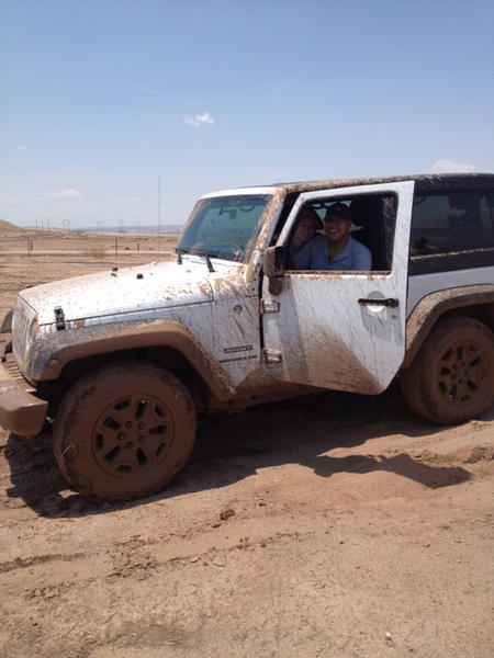

So I took my new 2013 wranger sport (stock) mudding with my friend and had a good time. I had so much mud in my wheels that it took me a few days to spay it all out but I also had a bad vibration cause of it, now that it's clean as a whistle (had to get the mud off to stop vibration) my steering feels like it wants to take off to the left or right on it's own. What could be the cause? it's very annoying to drive now please help! Thanks for any input!

Your problem is you obviously didn't get it dirty enough!
