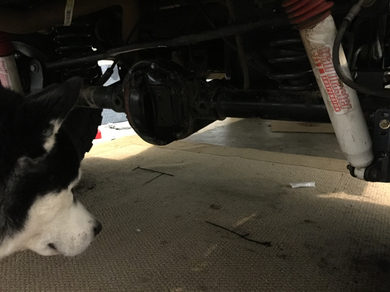

Thanks bro, rubicon Dana 44 with e locker installed. First time ever axle swap and solo 👍 noob but I'm proud of myself lol
