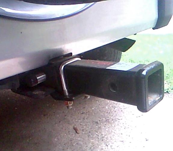

I use a hitch tightener on mine. It's really beefy/heavy duty. Works great. No wobble.
Tried duplicating it by buying a square u bolt (3/8", couldn't find anything bigger like 1/2") and a couple pieces flat steel - didn't work as well as this original.
Got the tightener with my hitch swing away frame from stowaway2
