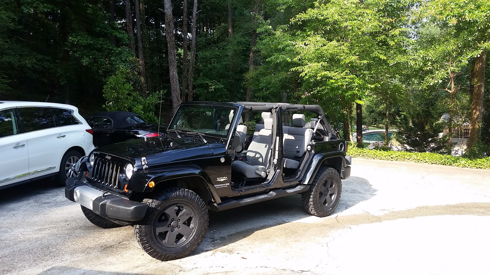

I just got my 2008 JKU a few weeks ago. everything works fine but the horn. the horn will honk with panic button pressed, and chirp when you lock the doors. My cruise and turn signals work fine. Is this a clock spring issue?
I posted a picture since I know how everyone likes pictures
