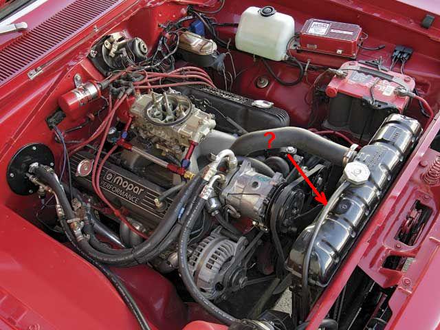

The Plymouth Barracuda was made from 1964 - 1974, not my definition of "modern".
Where does the hose on the picture goes?
I saw the reservoir of my JK yesterday while installing a clear bra and it's huge!
If the OP had to fill it within a year (under normal driving conditions) it is an abnormal loss.
As for where that tube goes...on a lot of older vehicles it merely pointed "down" and terminated towards the bottom of the vehicle. If the coolant expanded and needed to go somewhere, it simply "spewed" out of the hose to the ground.
