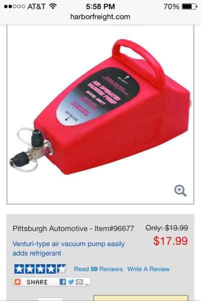

Harbor freight has an inexpensive tool for evacuating your cooling system. It connects to an air compressor. Technically you are not supposed to do this if there is freon in your system because you have no way to legally capture it. Anyway, I did this on my former vehicle with success. I vacuumed with the harbor freight tool, then filled using coolant purchased at autozone that had a built in pressure gage.

Your freon is already lost. Just get this $18 pump from harbor freight, then get a can or two of coolant including one with the pressure gage and do it yourself. I personally don't think you've got anything to lose. Maybe you can fix it for under $50.
