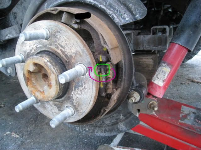

i got my rotor and caliper off and im wondering how to tighten it?
i know its a little weird ring but i just cant find it so any please point me in the right direction

I think Wol did a writeup on tightening the e-brake. Do a search in writeups

yep thanks man i figured it out after i saw the little star you twist!

This is from someone else's post, for those who don't know what it looks like.
The adjustment star wheel is circled.
It's accessible by removing a rubber plug on the other side of the backing plate.
