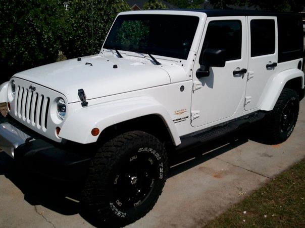

I bought a 2011 Jeep Wrangler Unlimited and I am not sure if I have LSD. I asked the dealer and they couldn't tell me or they were to lazy to check. some of the option I read on the sticker confused me wich lead me to ask this question
Does anyone know if thats standard on the sahara?

i don't believe so because I was looking at buying a 2011 sahara and it didn't have it but it was only a 2 door... not sure if that matters.

Just jack up the rear end at the pumpkin so both rear tires are off the ground. Now with tranny in neutral spin one of the tires and if the other one goes in the other direction then it is open and if it goes in the same direction then it is lsd.

No it's not standard. For a 2011 Sahara the Trac-Lok LSD was a 295 add on.
Yes the dealer is lazy. Could have run a carfax on the vin and gotten the options.
If there's no immediate need you can get the infor from Chrsyler in addition to the method described earlier.
