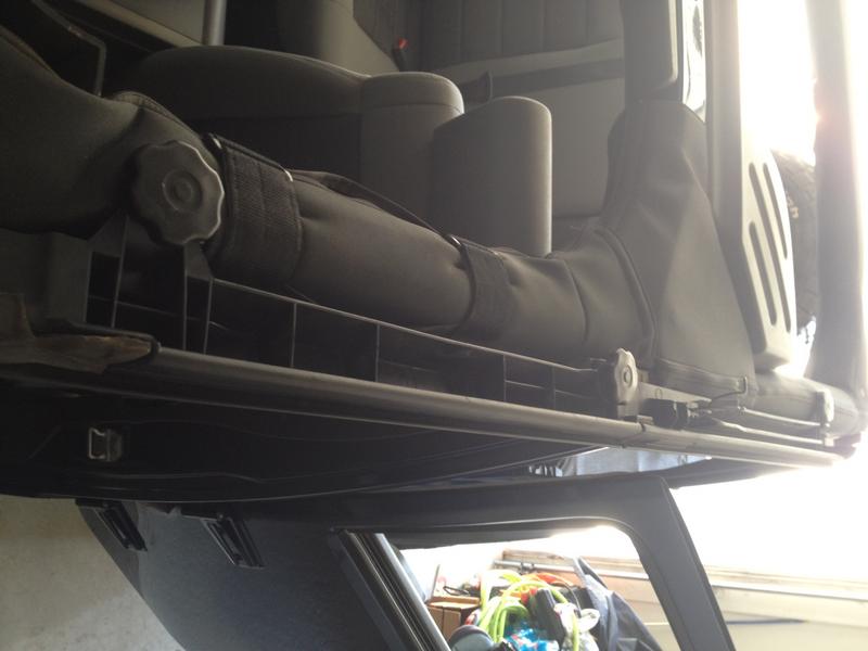

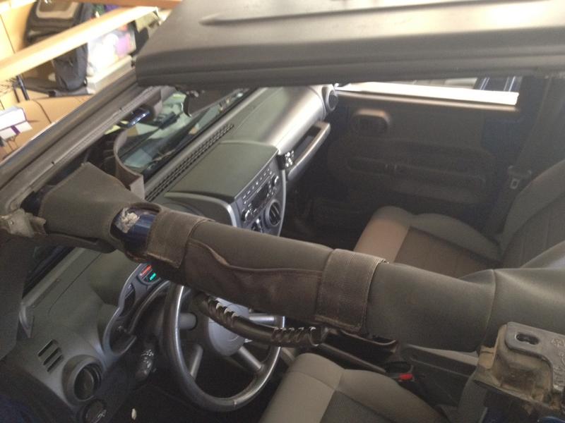

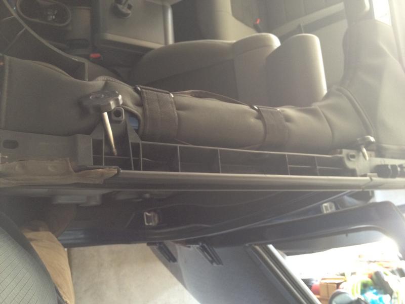

No leave the padding on. My top may be a bit different, because it is a 2011 model. But I have 3 screws on each side. A long ones for the front and rear and a stubby one for the middle. The middle one bolts the front and rear together.
Here are a mix of pictures. One has both the surrounds bolted in. One had the rear with rear surround next to the where it belongs. One is the front without a surround. One is with the front surround put on, but the bolts sitting on top.
