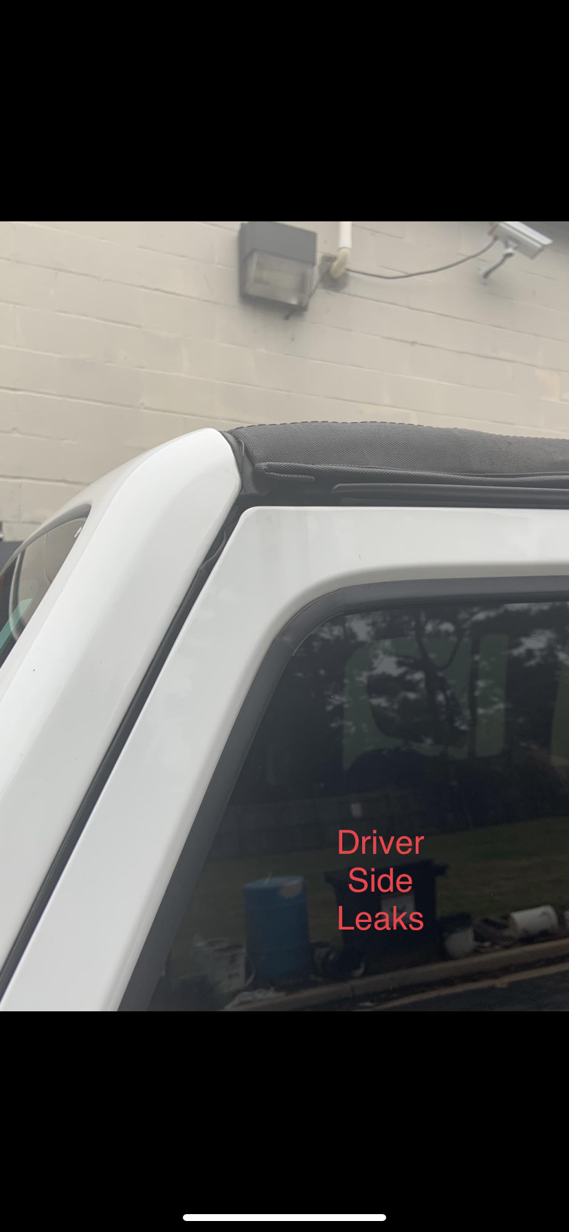

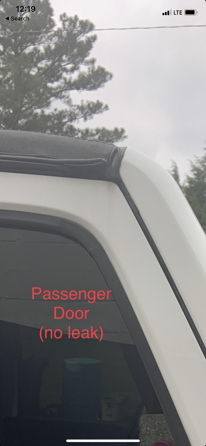

I have 2016 jku soft top, I’m not sure if I have put my soft top on properly. It rained and the front driver side is went on the floor. I was told that the forward header channel is too far back. But I do t know what I’m looking for to make sure it’s right. I included the pictures of the front. Can anyone help me please

Welcome to JKF.. Good Group here and great knowledge..Keep asking questions; keep us updated on your progress. 1st .. you should water test yourself; it is simple, just get inside and have another person direct water from a hose starting at the hood/windshield/ "A" pillar corner and gradually move the stream of h20 up while you watch for leaks.. do not blast the top edge 1st. Once you id where the leak is check for more videos on how to correct.. Watch this:
