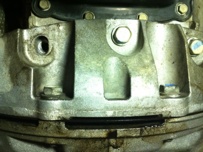

I checked my heat shields, and came across this:
Is there a bolt missing? And if so could this be my problem with the rattle?

Go buy 4 metal hose clamps and clamp the crossover pipe heat shield down, even if the welds are not broken the ends have 2 small metal band clamps that after repeated heat and cold will weaken and they will rattle.
Then buy 4 more small clamps and clamp the 2 metal flex tubes on the EGR pipes or cut them off, especially the one that runs down the back of the firewall at the transmission bell housing!
Your rattles will be gone!
