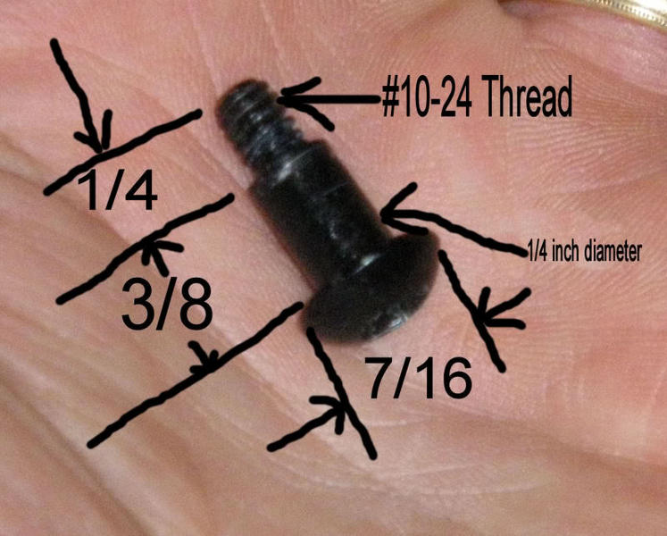

This holds the soft top frame to the bracket.Click image for larger version

I wish I had seen this sooner. That was what I was looking for...
