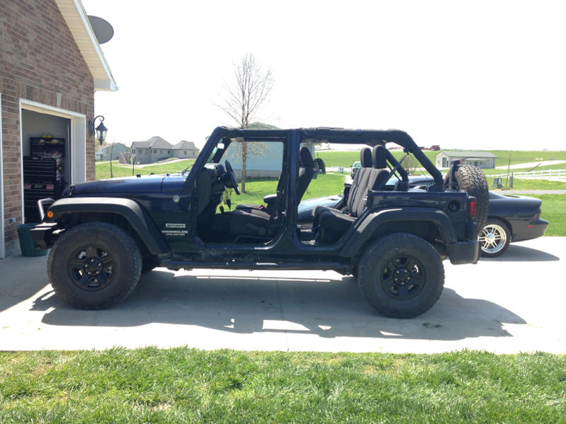

I ran 285/75/16 with no issues on mine since March when I bought it. I plan on running that size till I get money for 35's since I just did a lift. But ran this size stock with no issues.
