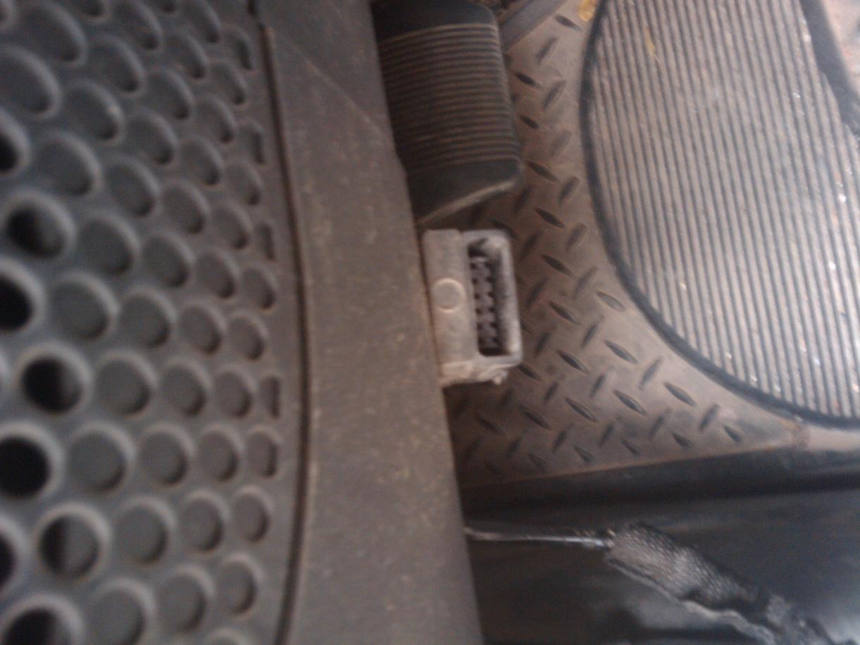

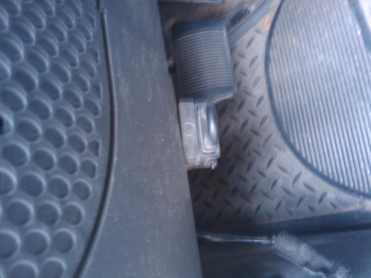

Check and see if you have a plug that looks like this and it is located under the steering wheel right under the dash.Its a theft lock with this plug pulled the jeep will not start even with the key. Im pretty sure the key alone is like $100.00 then you may have to replace the ingnition and for sure reprogram the computer.I may be wrong but it sounds like its gonna cost some cash.

I forgot to add the picture.
