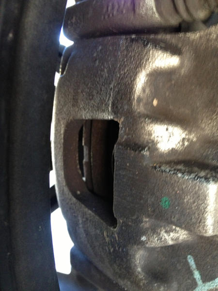

I would say, I think I've found the issue:

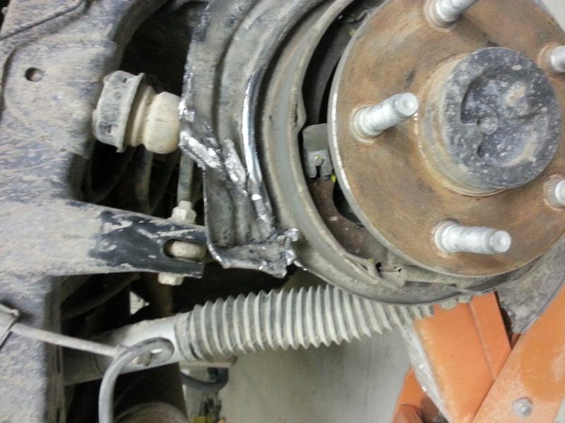

I had a similar sound and it ended up being the dust guard behind the rotor rubbing on the rotor every time the brake was applied. A rock bent it

Default that was my guess too !
however he thinks he found it but im not sure what he is seeing realy ?? maybe a piece fell off and is scraping in there ?

I ignored this one day and ended up ripping my caliper off and making a mess of the dust cover.
