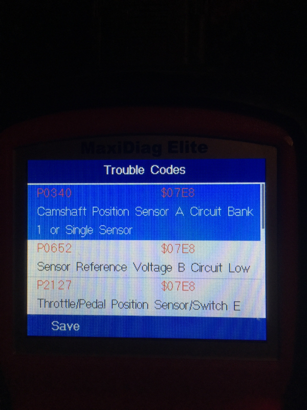

Okay guys, my 2011 JK has recently started acting up, going into limp mode, traction light coming on, wreck engine light coming on and the " lighting bolt " limp mode light coming on. The codes are camshaft sensor which I replaced last week, acceleration pedal sensor and a couple voltage codes. It has been running great up until last week, after it done it the first time, I changed all plugs and wires and replaced the cam shaft sensor. I thought that fixed it but sure enough it happened again yesterday, some times it will crank and crank until it finally starts up but then runs like crap. In limp mode. After reading through many forums it seems to me like this is common but I have not seen any solutions. Please guys help me out, I don't want to throw money away by replacing a million different things that doesn't fix my problem. Did any fix this issue??

I would make 100% sure your battery is working properly. Many people have suffered unusual problems when their JKU battery went bad. When mine went bad, crazy things were happening with the idiot lights in the dash. Also, the speedometer stopped working and the tachometer looked possessed. Since you mentioned some voltage errors, that seriously makes me think the battery should be checked. Don't just read its voltage. Take it into an auto store and have them load test it.

I didn't make it to town yesterday, I ended up having a few errands to run. I plan to take it this afternoon though. I did however do a sea foam treatment to it last night through the break boost vacuum line. I took it down the road and she purrs like a kitten. That's what drives me crazy... I never know when it going to do it. I did find a wire ran to my fuse box that I removed ( looked like a remote wire for a radio the previous owner must have had) it was running to nothing under my dash. I'll update tonight after I take it for the batter and alt test. Here's a pic of my codes.
