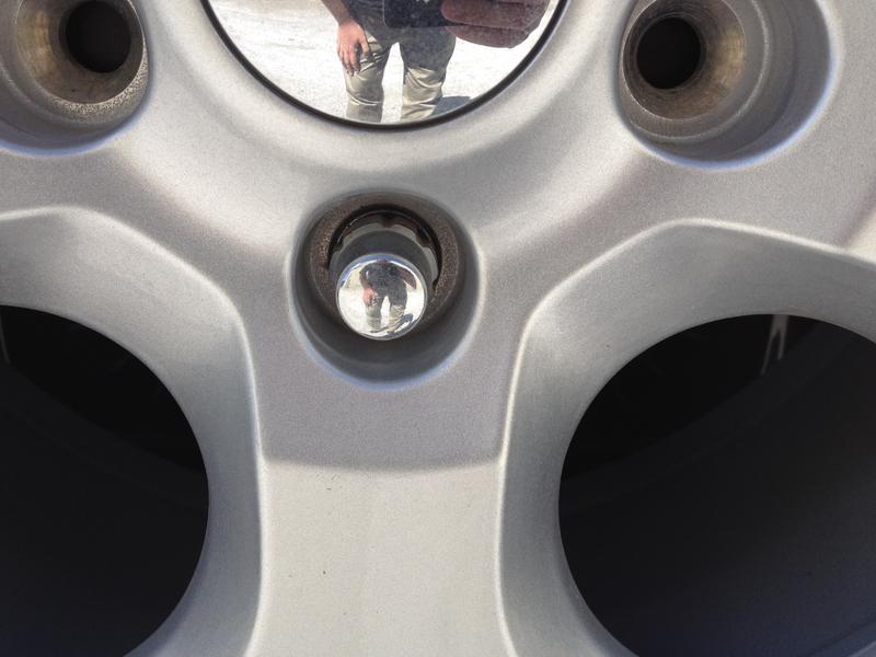

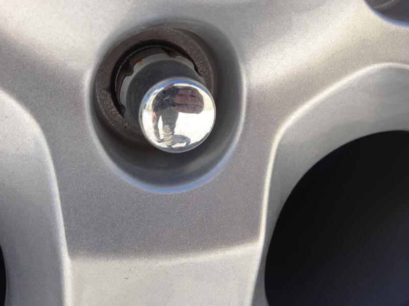

Hi Everyone, I picked up my brand spanking new '14 JKU Sahara after trading in my '12. I found in the glove box a package of locking lugs similar to the first picture i have attached to this post, when I tried to put them on my wheels i found i already had locking lugs (2nd and 3rd photo attached to this post).
My dealer had the Jeep transferred from a dealer 4 hours away and they didn't send the key and when they made contact they have no idea where it might be.
My questions are:
Does anyone know what brand my existing locks are? I
f you do know the brand which is better?
I like the locks i have on the Jeep now, honestly i think they look cooler but ultimately i would like the ones that are better quality and i figure i can order a key if i have to. Any help would be appreciated.

Yep, they look like Gorilla. If you have a Discount Tire nearby, they should have the key as I believe they are universal. The set I bought a few days ago use the same key as the ones I put on my wife's JK three years ago.

The set from the glove box if the key is not placed just right can and will deform the raised lock pattern making it pain to take off.. As for the locks on the wheels they very similar to the tuner lugs that my local tire place install on my jeep.. I'd head over to a big name tire shop and ask about a tuner lug key and see if it fits your lug..

Looks like gorilla, not all are universal. They actually have a coded socket for the lug nut on your vehicle. Try calling them, explain the situation and take a photo of the lug so they can see the splines. You can also get a mold of it with playdoh, fill it with epoxy and send it to them for matching.
Check the vehicle for a gorilla sticker with a key number on it as well. Tool well in the cargo area, give box, owners manual, etc.

I would agree the locks on your wheels right now look exactly like the Gorilla brand ones on my Jeep right now. Like someone else suggested, check around your jeep for a sticker that will have a number you can use to order a new key from Gorilla. Should be gray/silver. Check glove box, center console, rear door, any storage area.
If that doesn't work, give Gorilla a call, explain the situation and they might be able to help you out.
