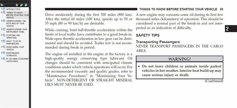

Read your owners manual ... I wouldn't tow until you break in your new 2012.
Name:	2012 Wrangler Break In Procedure.jpg
