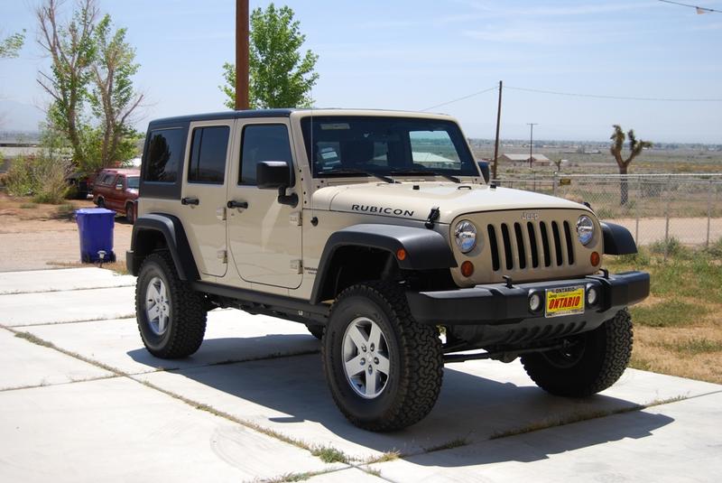

I just got a new 2011 rubicon and put a four inch lift and 35 bfgs on it. My problem is now the jeep keeps telling me I have low air pressure when I don't. Is there something I can do to fix this. Thanks for any help given.
