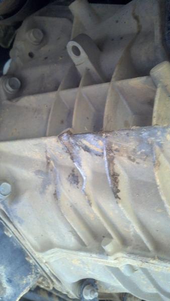

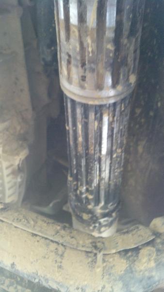

Here is a pic of my front driveshaft and transmission.

Old Sep 29, 2013 | 01:15 PM
dcharge74's Avatar
Posts: 1,180
From: Sinking Spring, PA
Ahhh, now I see what you meant. You need to get some skid plates if you're going to be doing any serious wheeling. That could have been a lot worse.
As for the driveshaft, you can get a new boot and clamps. You'll need to uninstall the driveshaft, separate at the slip joint, slide on new boot, reassemble driveshaft, and tighten boot.

I would just use this as an excuse to upgrade the drive shafts
