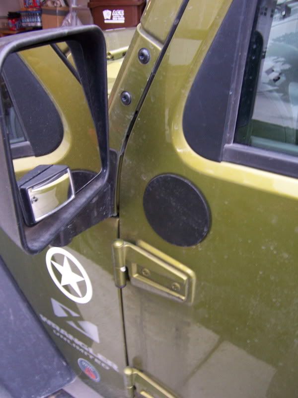

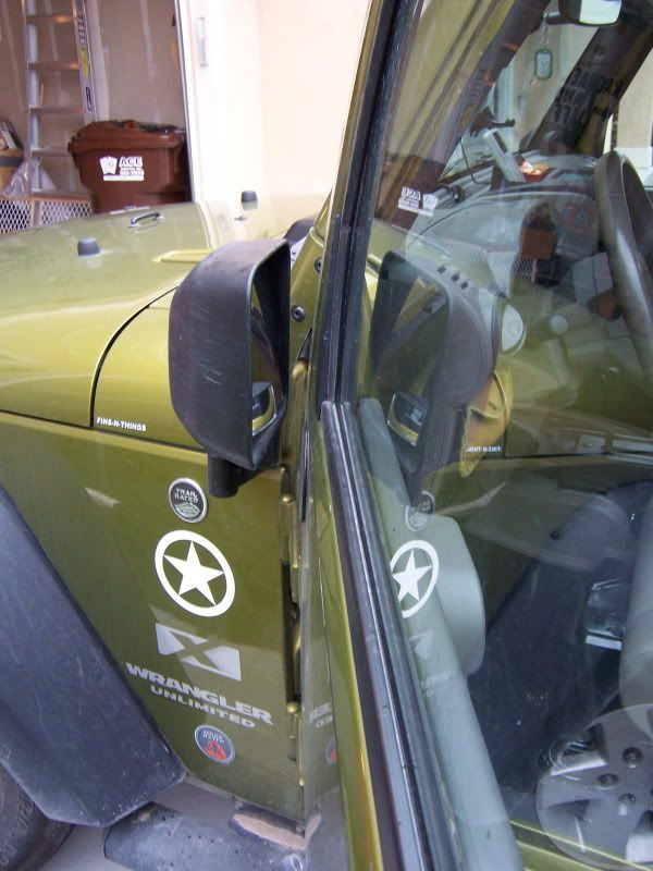

Here's a little bit better picture of the Mopar option.
I remove the mirror (60 second job), but leave the bracket in place, when installing doors. You can see the bracket in this picture (right above the Trail Rated badge) ...
