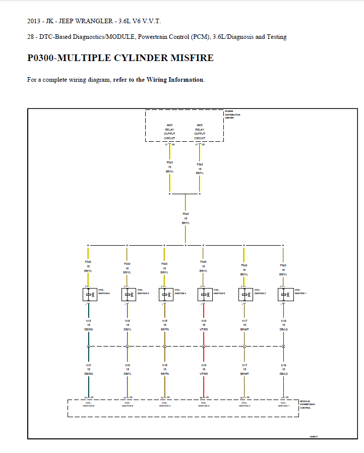

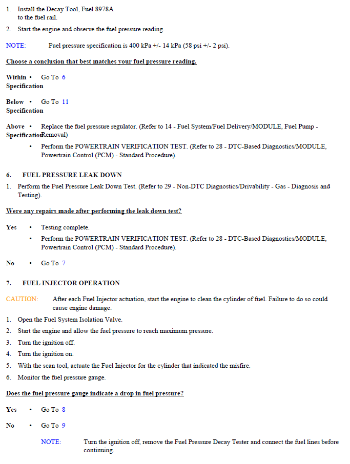

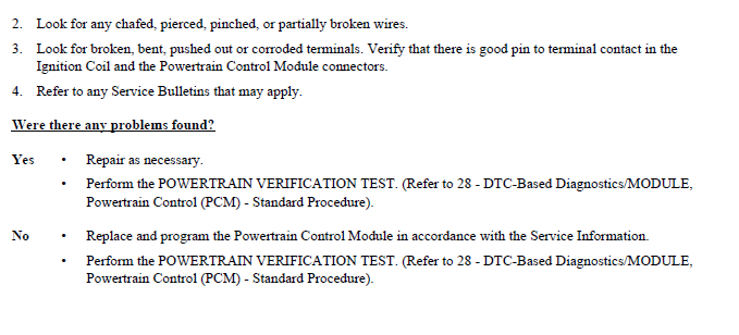

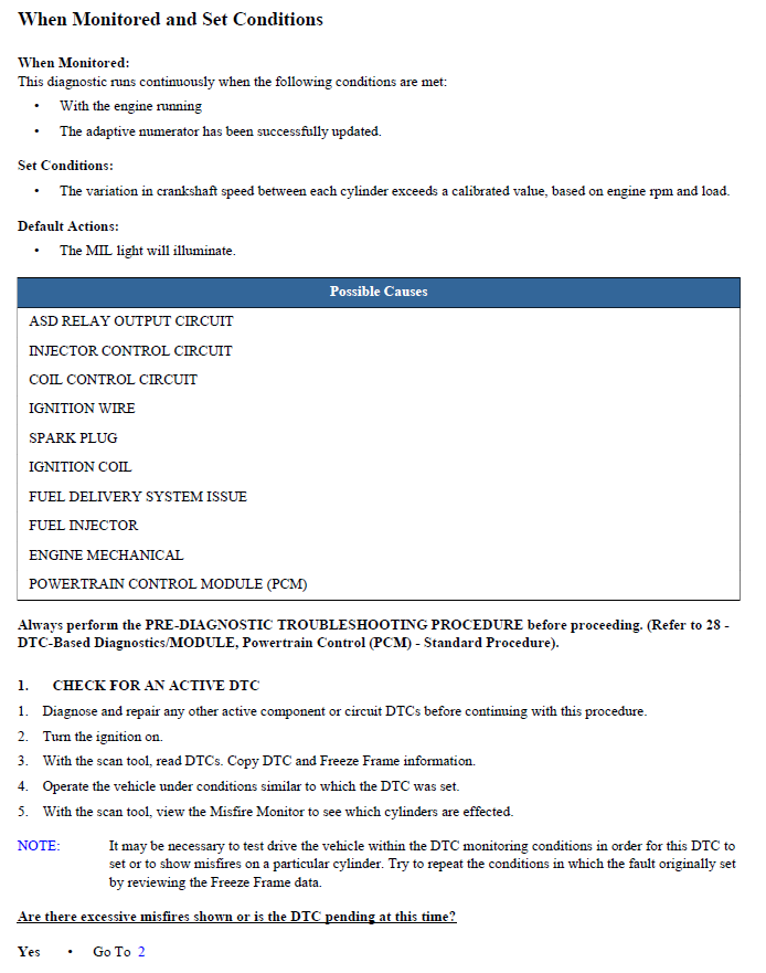

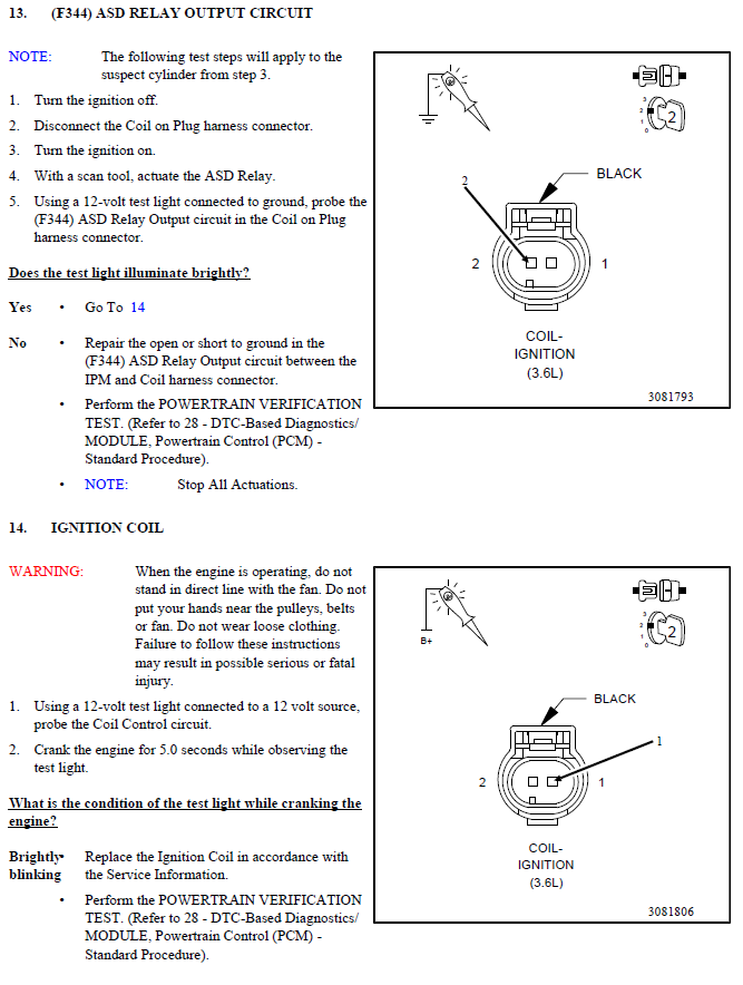

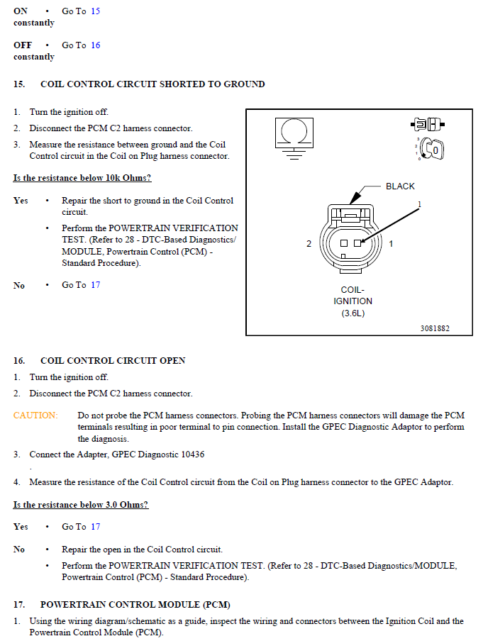

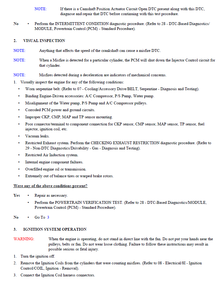

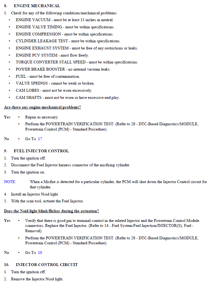

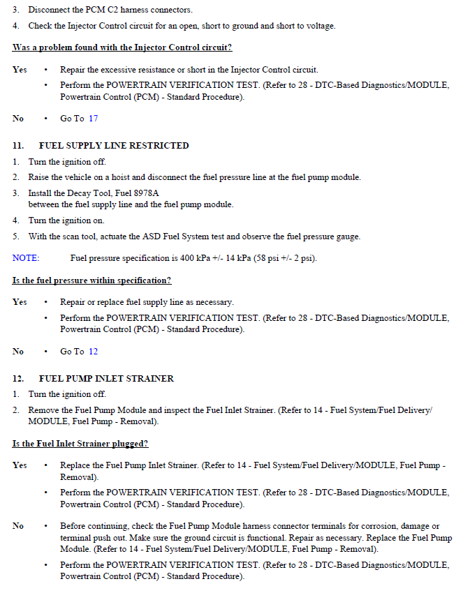

Have you done simple compression test? It is typically right here that I cus about that damn intake covering up the driver's side bank and making what should be a 5 minute task take longer. I think at the very least though do quick compression test on cylinders 1/3/5 due to such easy access so you can compare if 5 is reading off.
Here are snapshots of pages from the service manual regarding P0300 (multiple misfires) -
